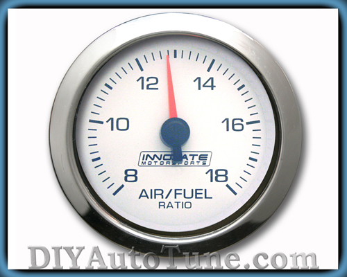

I've got the Innovate LC1 with a G4 analogue type gauge under the dash. Never had any problems and wouldn't be without it now. Theres a cable under the dash to plug it into the laptop but I've never even tried it. Just wanted a gauge I can see at all times.
G4 gauge.jpg (139.65 KiB) Viewed 1765 times
