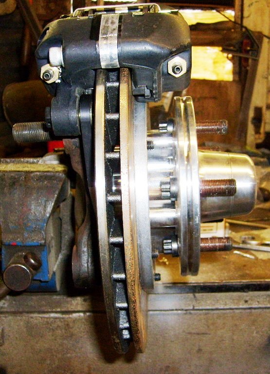

Longshot
My car was a 68 front disc A body to start with ( obviously with disc spindles )
If you use the Wilwood Dynalight package all you need to do is spin the spindles down on a lathe to accept the rotors etc.
The caliper bracket which is lighter black / dark grey in picture number S6302127 needs to be cut / drilled / repositioned for clearance
The arms / balljoints all remain the same allowing the completed unit to be bolted up
