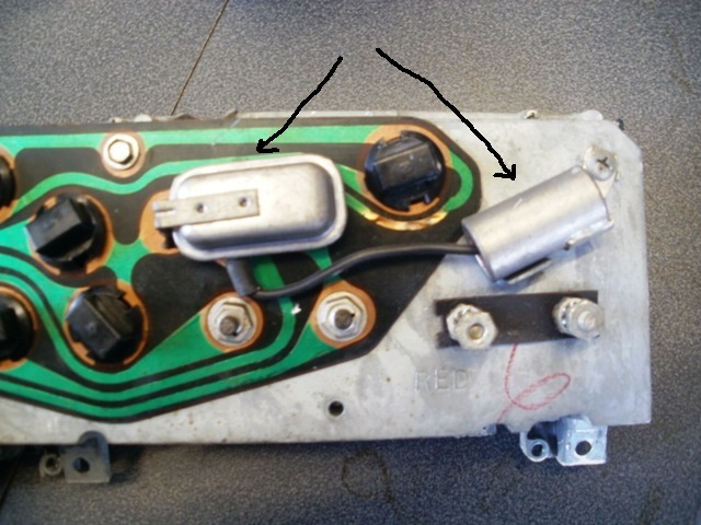

Temp gauge not working on my roadrunner & petrol gauge always reads lower than it really should.
Have continuity checked the voilet temp wire from the clocks to the temp sensor, fine & tired earthing the wire but no movement on the gauge.
circuit board on clocks looks really good with no cracks etc
Now the dumb Questions..................
So am I right in thinking it is probably the voltage regulator ?
Is the voltage reg the 2 parts on this photo with the arrows to it ?
Can I test it ?
Who's the best to get one from ?
Anything else I can do ? or could it be the gauge itself ?
Can I test it ?

Bin it and build an electronic one from parts out of Maplins for a fiver and get a constant 5 volts to the gauges without any fluctuations.

Sounds like it firstly - from experience I had - yes that is the voltage regulator your arrows are pointing to. You probably can test it - One of the Daves or someone with more knowledge than me will point you in the right direction if you can use a mutiimeter. If replacement is required dashworks in the states do an upgraded one for $55 if you can't find one here or want an upgrade .

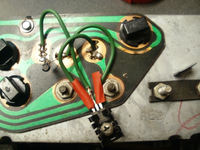

cheers lads for all the info, am going to do the conversion highlighted by Mr Norm & Anton, very well explianed on that link, the voltage is fluctuating from 2-4 volts, but think its the temp gauge itself that is u/s

did a quick hnd in electronics then this conversion as per the excellent link above, Adrian (top man thanks again) gave me a temp guage out of a van, with a different face but the same mechanism behind, so carfully drilled out the tiny rivets & swapped the facia over, tried it but could not get enough temp in car idling in tonight's northern condition's so shorted temp gauge to earth & flicked ingnition on & bingo temp gauge started to move
Cheers for everyones help
& thanks to this club its fixed.

Electronic dash regulator- can they burn out?
All 3 dash gauges on Charger fried.
Old regulator pushing out 12 volts
3 new gauges + Built an electronic one and fitted into gutted old regulator.
Coming home yesterday hit the same problem- 3 gauges way off to the right. Stopped car quickly and pulled wires to all 3 sender units.
Back home checked the electronic regulator- 12 volts at both terminals
Opened it up. No shorts, just 12 volts at the 5 volt terminal.
Did it burn out and short to the input voltage?
Could a voltage of amperage spike cause it to fail?
Before it failed I blipped the throttle on start up and the amp gauge was 30-40 amps.
Bit stumped and can't afford to risk the gauges again.
Cheers
Eddie
Cheers
Eddie
In Andyrob picture I cant see the capacitor to protect the chip against voltage spikes and that could be you problem.

I had to look 3 times before I saw it, I must need stronger glasses.Demon James wrote:The cap's pointing straight at us Anton, just by the ground track at the left green wire
