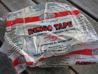

When you finish the leaf springs what is the best way of painting/treating them so that the movement between the leaf springs does not create rust and show through....Don't really want to dismantle them either as I am lazy ;)
74challenger318
Post by 74challenger318 »
Pete wrote:When you finish the leaf springs what is the best way of painting/treating them so that the movement between the leaf springs does not create rust and show through....Don't really want to dismantle them either as I am lazy ;)
Wrap them in denso tape, keeps them lubricated and out of the weather
Posts: 13000
Denso tape is a top tip, a mate of mine has also tried shrink wrapping his springs...yet to see if they last the distance though! 8-)

Me a distributor of Denso tape, 2,3 & 4 inch wide, always in stock ;)

Adrian Worman wrote:Me a distributor of Denso tape, 2,3 & 4 inch wide, always in stock ;)
Im also think about what to do here.
Strip sandblasted and have galvanized ??????
Got to best.
Heat shrink sound good
Whats this Denso tape ?????? Rubber ????????
Posts: 5895
Wont galvanising get them too hot and lose the spring temper?
MattH wrote:Wont galvanising get them too hot and lose the spring temper?
I have no idea to hot dip galvanized would be dunked in a bath of liquid zinc/lead at 370°c
Would this hurt ??
Powder coat them ???????
