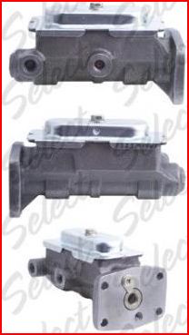

The Aussie MC upto 1970 is based on a Dart (or other mopar) MC of the late 60's, it seems just the ports are on the opposite side.
Like this one in the pic
Was thinking that I could try to bodge it with a piece of clear hose through the middle of a cork and cut the cork down to screw/push into the thread far enough to cause the hose to flare over the pipe fitting.
Or as a last resort use the idea Dave999 came up with when we were talking about it last weekend. submerse the whole MC in a container of brake fluid then pump it. - My reservation with this is that the MC will be vertical and not be on the horizontal as it is when mounted, when pumping this may cause some air to get trapped around the seal if it is higher than the internal ports to/from the bore.
Dart MC.JPG (22.46 KiB) Viewed 875 times

That master cylinder looks just like the new one I bought for my Polara. It was £50 brand new and came with plastic blanking plugs for the outlets for use when bleeding. If you want, I can dig out the plugs and send them to you to try???

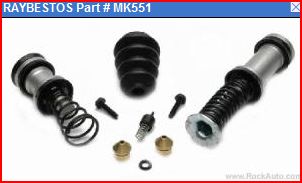

Am going to put a kit through one of my MCs. Has the 1" bore like the US ones so have a rebuild kit from Rock Auto... no plugs though.
Dart MC rebuild.JPG (18.88 KiB) Viewed 850 times

I'll be fitting a pair of calipers that I just rebuilt so will also be bleeding the whole system... just don't fancy spending hours trying to bleed at the wheels so want to bench bleed the MC properly or as best as I can.
