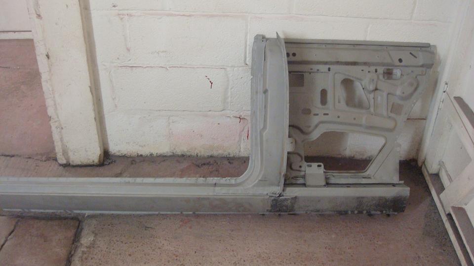

Got Mick's crash damaged Coronet to fix.
After cross checking the chassis, i cut away the scrap metal.
Mick got hold of a complete sill section with b post, so after blasting i lined up and welded it in :thumbright:
New panels aren't here until late December so cars going in to storage next week.
Some pic's to be going on with :D
mick's coronet 001.jpg (79.25 KiB) Viewed 1428 times
mick's coronet 003.jpg (91.18 KiB) Viewed 1428 times
mick's coronet 008.jpg (97.81 KiB) Viewed 1428 times
mick's coronet 011.jpg (95.55 KiB) Viewed 1428 times

Posts: 22109
Cracking work Ashley!!!
I KNOW this is a stupid question, but why did you have to change or remove part of the floor panel? is it connected to the inner Sill, etc?
Great pictures, whows how weakly they were build - I am starting to wish I hada post car.......

Post by Ashley »
Pete floor pan was rotten :( If this was a post car the damage would have been alot worst, with the roof been dragged down with the impact.
