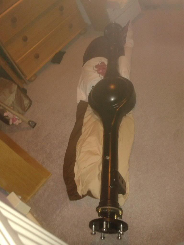

Well Santa dropped by today too deliver:
Image (Sorry for the quality).
The axle housing is fantastic, nicely powdercoated and looks the part:

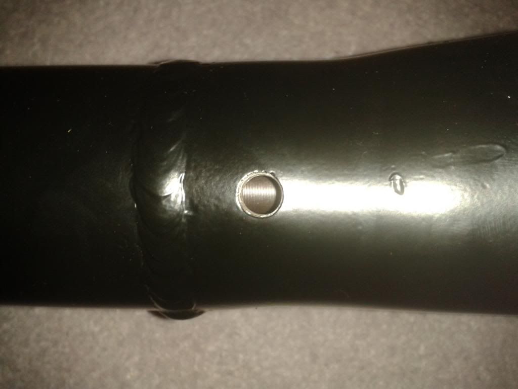

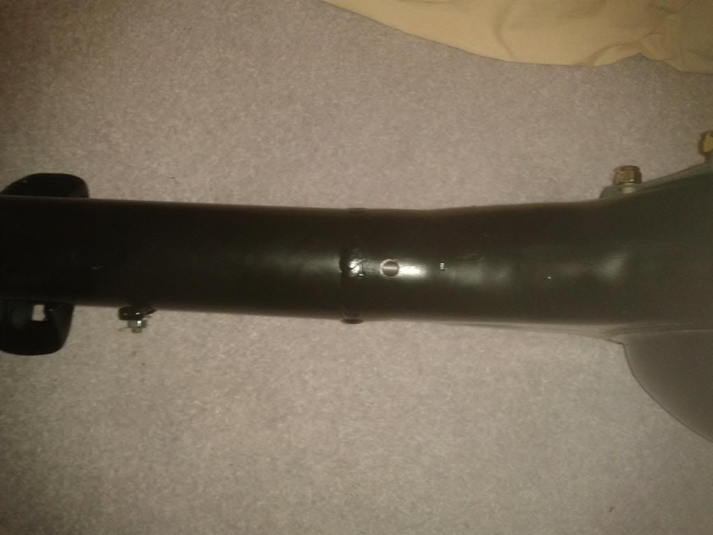

Had a good look round and when moving it round i came accross a threaded hole on what would be the underside of the rear right:
Nothing on the left side. It doesnt match up with any of the mounting clips for the brake lines...........So anyone have any ideas??

Probably the axle breather/brake pipe union.......you need to check against an exploded diagram.

Yes, that's where the breather goes, it's on top on the left side.
your flexi pipe bolts down on to it,
Cheers Chaps, just had a look around and my first mistake is looking at the diff the wrong way up.......God help me!.
Tis on the top of the left side.......... :oops:
Had a look in the 72 Service manual and it just shows a tee and screw arrangement.
Is this easy to source over here??

That is where the breather goes, you will also find that where your brake pipes run they have a T junction there. One bit goes on a flexi to the chassis junction, the others go to the left and right brakes.

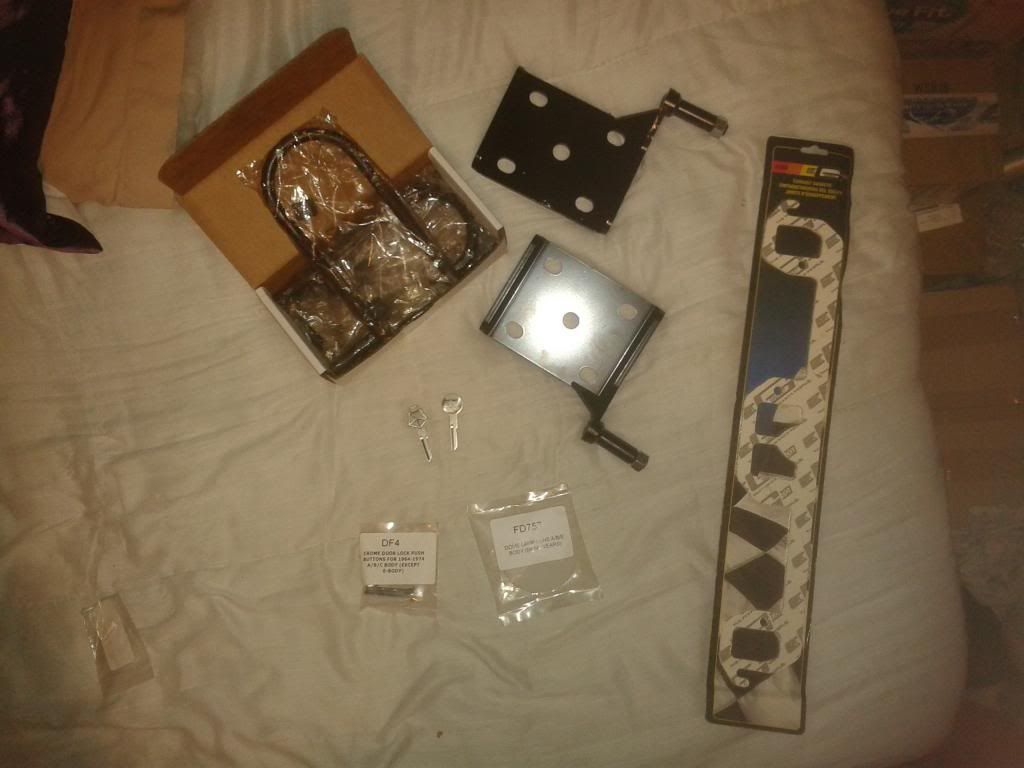

As for the shock plates and u bolts, already on it Justin:
All from Mancini last week....More clean shiney parts! :D

Going back to the breather:
http://chucker54.stores.yahoo.net/axlevent.html
Is that what i need.........$26 for a vent. Add on shipping and its a £35 part......... :shock: ?

thats the one Dave :thumbright: have you got the brass fitting that splits
the rear brakes the goes on the vent? got one here somewhere if you
need it
