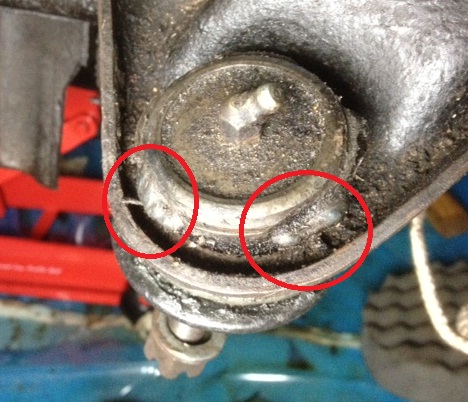

Just a quick sanity check.
Cracking the big nuts on the upper balljoits (20ft wrecking bar at the ready :) ) but something odd.
The socket wont go on as they seem to have been spot welded ???
I mean I will grind it off and see if they go, but is this normal ? I assumed it was grease at first but it aint - its weld !
Posts: 5235
not normal, but i'm sure someone mentioned on here doing that in the past for extra security so the joints don't pull out as it's only a fine thread ...
It has probably failed at some point and someone has done this when installing the new ball joint (or re-installing the original one as a bodge).
For safety you will have to assume the worst and replace it.

Yep Bodge...i'd change it. :shock:

Shiny new moogs boxed and waiting - this one just has to come out !
Thanks all. Thought it was odd...

I think the point is that most people would counsel changing the UCA as well as the ball joint........
That was a common way to repair the UCA without replacing it .
I was poor and did the same thing I just didnt have the money at the time and later sold the car,
Yea a good idea to replace it :thumbright:

The ball joint in threaded so is the top arm.
You screw the ball joint in and stop at a set torque
Over the year people have over tighten them and the top
arm treads are Bananarama!
one of Mine new ball joints where so close to the torque and i felt it start to slip.
I think the tread design is bad and could let go when you do duke jumps.
I welded mine on both side and they ant going anywhere now.
took me to long to weld them wings up
When a ball joint goes i will buy aftermarket top arms with a modem ball joint design,
Anton was making some i think try asking him

Also over the years some have pressed them out in a press, not realising they are suppose to screw out.........another way to knacker the threads!
But if you can grind out the weld and get the balljoint out, have a look and see what the thread looks like. Sometimes the weld was just a belt and braces, you might be alright.
