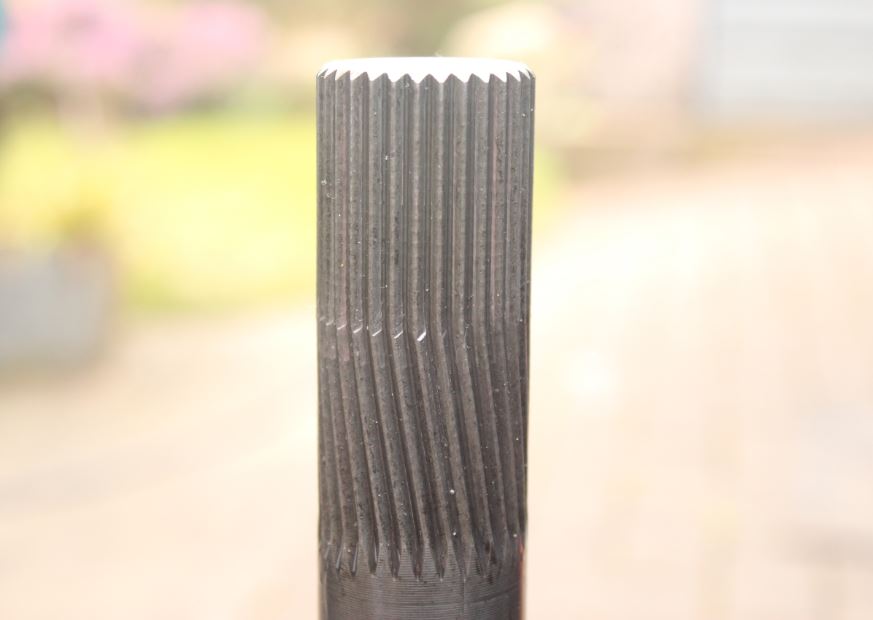

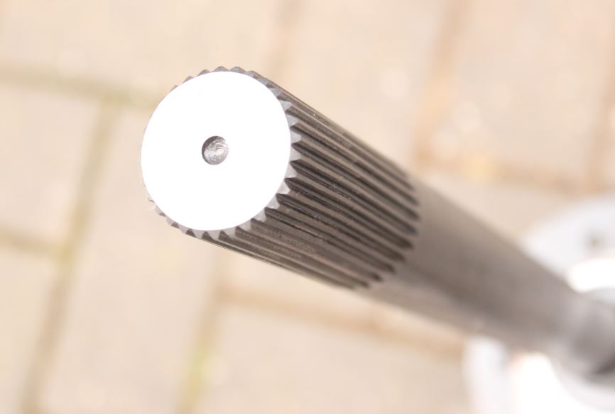

removed the halfshafts today to find see if anything was wrong
Can you can spot the problem
I can feel a visit to Hausers coming on

What shafts are they Guy?
Torsional Stress/deformation.......... :-k
Never seen anything like that before.......What kind of power are you putting through the rear Guy?

Posts: 6740
A set of Slicks, prepped track & good traction will try to screw the hell out of most shafts . . .
As Pete said, I also thought you upgraded your shafts, they look after market ? 31 Spline, hard to tell from photograph ?

These were the the old shafts but were not twisted before as I had had them out before and would have noticed. I have not taken them out before now as my garage is too small to get both wheels out from under the car and I had to wait for the weather to improve ( no hard frosts) before pulling the car out so I am able to work on it.
Thanks Ivor I shall try that next time ;) it would save me a fortune..
Dave81-What kind of power are you putting through the rear Guy?
to be honest mate i'm not sure but its not enough :lol:
You are right mark the are after market units and were Strange race shafts not the street strip shafts. Anyway I dropped the shafts in at Hausers and have a couple on order but I may be doubtful for Gary's Picnic :cry:

Are they stock spline Guy ?
I ran stock spline moser shafts in my old 8-3/4 for3 yrs or so and the axle's still going strong in a friend's high 12 sec, 4 spd truck with 5.13 gears.

Did that to a stock set with a 383 and a 4 speed...
My Challenger still had the OEM shafts in and still has as far as I know. No sign of damage despite many hard launches.
Good steel in those days. :D

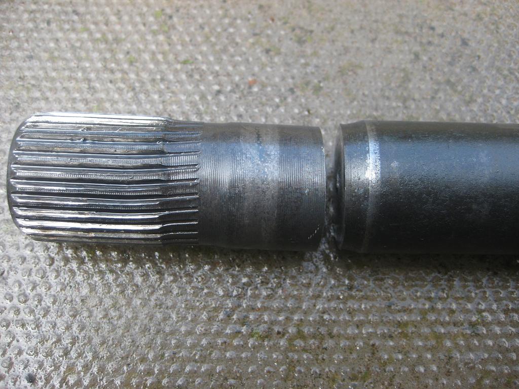

This is what happened to one of my OEM shafts on the start line at the Pod.
broken axle shaft 004s.JPG (78.24 KiB) Viewed 1538 times
broken axle shaft 003s.JPG (141.31 KiB) Viewed 1538 times
:shock:
