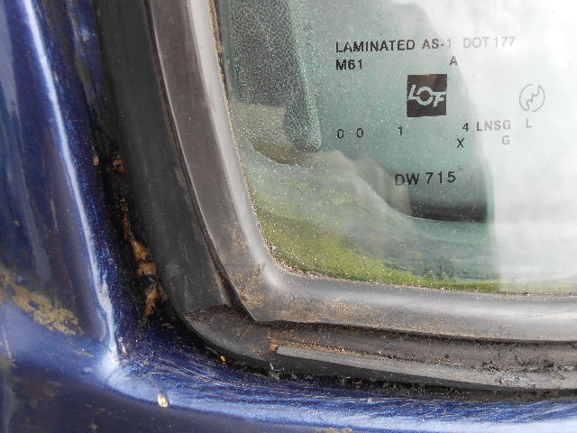

This is embarrassing!
Just lifted out the chrome surround and found more cheap and nasty black sealant than enough.
What next? How should i go about getting the screen out or leak repaired?
- leaky screen
- DSCN0336.JPG (70.27 KiB) Viewed 885 times
- lower pass. side corner of screen
- DSCN0335.JPG (75.72 KiB) Viewed 885 times
That does not look like a bonded in screeen to me.
Usually the rubber to steel is the leak point, so the best solution probably is to take the screeen out, clean / replace the rubber - ensure there is plent of sealent to the bodywork and then re-install the screen (If you have not already broken it like I did
Good luck.
Also bear in mind that the wiper spindles are prone to leakage and also the Plenum rots through so that could also cause internal leaks. Lots of choices on a Mopar!!!
Good luck.

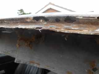

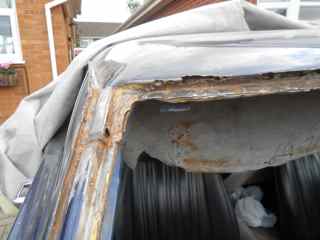

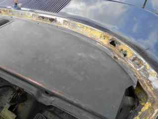

Thanks to you guys managed to get the glass out without breaking it. Took the easy way out and cut the existing rubber at both sides and the top then the screen pushed out easily enough to lift out, just like Dave said.
Found about 1/8th inch of filler covering all holes, both rust and the drainage holes. Have now removed the filler and the photos show what an inglorious mess I'm left with. The car originally had a vinyl roof, does this account for the lack of finish at the join between the roof panel and the A post? There does seem to be plenty of decent metal to weld to but before I do that any helpful comments would be appreciated.
