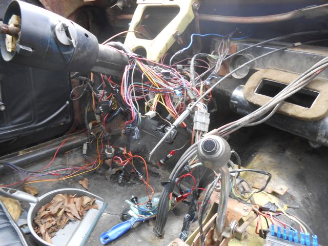

- That'll be the wiring then
- Bee43.jpg (73.75 KiB) Viewed 655 times

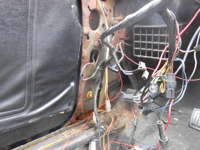

- Driver side rot

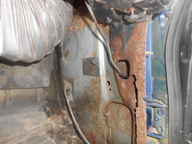

- Pass side rot

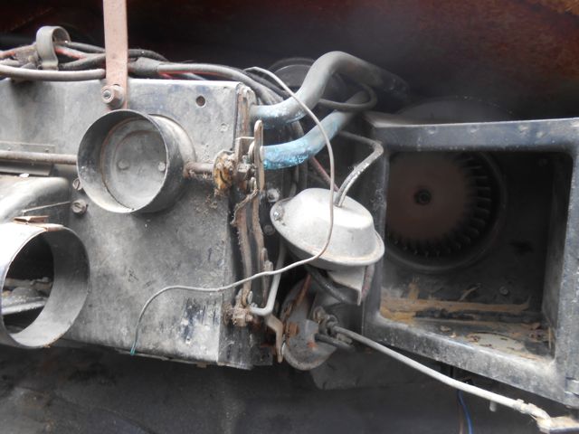

- AirCon/Heater inlet

As far as the heater box goes, just pull it all out. The air con unit can be rebuilt but it'll be expensive. Having said that its a neat option to have on a car already worth saving. Grab a used std heater unit from someone on here and use that while you research restoring the factory piece.
As for the rot in the posts, I've seen worse, you've done loads so far, just keep at it.............. seeing rust in all sorts of places puts you off easy, but in reality the patches are fairly easy to repair and they just become a longer list of jobs to do. Nobody is gonna see that one anyway

I removed the A/C from my Cuda rightly or wrong but I have no heater as the engine does the job fine but when it rains it not good
instant steamed up windows
so I don't use it in the rain....simples
Get a heater to replace the A/C and keep the A/C unit to go with the car if you sell it.

Just remove the AC aspects of it. There is already a heater core in there as well.
On my car I removed the AC and the Heater core (because the heater core was leaking) but kept the heater box, ducting to the screen, and fan.
I simply fixed the various trap doors in the system to blow up onto the screen. Then fitted switches to work the fan at its three speeds.
That way, if it rained I could keep the screen clear. As I usually only used the car during British Summer Time it never needed the heater.
