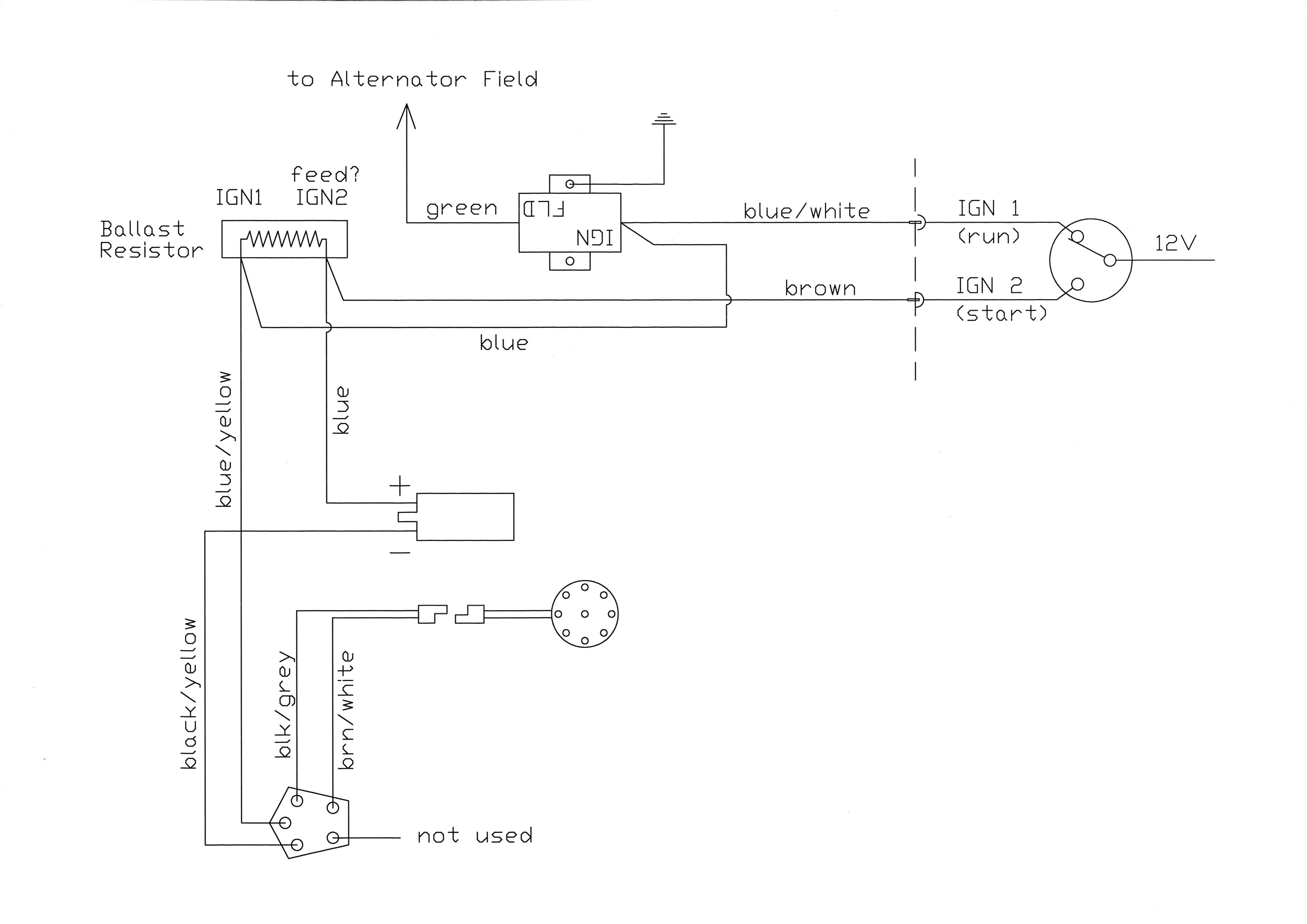

Been having a few starting problems with the Satellite recently. Pete W kindly came over a few weeks back. With his magic touch and a spare 'chrome box' it started ok. Next plan was to set up kickdown which was fouling on the exhaust, which seems ok now (at least the linkage moves freely & springs back as i think it should), then go for a test drive. But guess what, it wouldn't start again.
This seems odd as since fitting the Orange box last October it's been fine. this did replace the FBO equivalent that lasted a few weeks. We've got one of those new fangled 'Rev'n'Ators' to fit but don't want to fry it.
So i've been trying to check that the Electronic Ignition conversion is connected correctly, changing a few components and generally going blindly round in circles as i'm no sparky.
Most circuits i've seen shows the 4 wires from the ECU connected as i've shown below (which is how it's connected) however there was an article in Mopar Muscle Magazine that said to connect the blue / yellow wire to the other side of the ballast resistor, with the brown wire.
So the other night I swapped the wire on the Ballast resistor but that didn’t help. Just turning over without firing.
So I refitted the Chrome box in place of Pete’s old blue one, and when I turned the key it actually ‘coughed’ while cranking.
But after that I couldn’t get it to fire or even cough again.
I haven't got a meter so can't check actual voltage or continuity, but with a test lamp between the brown wire on the Ballast and earth, the bulb does go bright when turning the key over to 'start' so should be 12v not 9v.
So other things to check?
a. Need to try to check continuity between BR & ECU as the blue / yellow ire has been extended. Also the 5 pin cap is a bugger to fit so I’m not convinced it’s connecting right.
b. ECU itself- is something knackering them?
c. Too much resistance in BR? will check today.
d. Still unsure whether ECU is connected to the correct side of the BR
e. Checked there was a spark off HT lead from coil but unsure how strong it was. So I’ll try to see if there’s a spark at no 1 plug.
f. Reluctor gap, need brass feeler gauge though (non-magnetic).
g. Seems to be a fair bit of play in the top plate in the dizzy so maybe swap back in the old MP one?
Been using the power pack for starting so should be full voltage.
Are there any wiring faults or is it likely dodgy earths or something simple? i have got earths from ECU body, bulkhead to engine, batt to engine & body and the voltage reg is screwed in with a crinkle washer.
Any comments / help greatfully received.

well that diagram shows 12 volts to the coil in the start position
and 9 volts to the coil in run
the blue/yellow is 12 volts power to the box all the time.
all good
you need to find out which of your blue wires goes to the coil.
with them the wrong way round at the ballast when you try to start
you will be sending 9 volts to the coil with a massive load on the battery reducing it further to possibly 6 volts
and in run you will be powering your Box with only 9 volts
which is not enough to push the 2 amps it needs to do its thang
hence car won't run
its a 9 volt coil
when in start you feed battery voltage direct to the coil which should be 12 volts but probably isn't due to the massive impact the starter motor has on the whole system
its something like 10 or 11
If boxes are being killed
do you have an electronic regulator
if you don't the mechanical regulator can cause spikes and can allow a back emf to come out of the coils of the alternator and zap stuff
however unlikley to happen beacsue you tend not to stall when the alternator is active excited and on.

The ignition switch itself can often cause this problem. But you really need a meter.
1/Remove the wiring connector from the orange box amplifier.
2/Turn the ignition switch ON.
You should have battery voltage (within 1 volt) between earth and pin 1 (blue/yellow wire). Also pin 2 (black/yellow).
3/Turn the ignition OFF.
Pins 4 & 5 connect to the pick-up coil in the distributor. Connect an Ohm meter accross these two pins. The resistance should be within 150-900 ohms (400-600 prefered). If is isn't detatch the dual connector at the distributor and check there. If the coil is still not within spec replace it.
Connect one lead of your ohm meter to earth and the other to either coil pick-up connector. If you get any reading at all replace the pick-up coil.

Dave (999), the V/Reg is fairly new from US Automotive, so i presume it's electronic as opposed to old fashioned mechanical (?), and the coil is an MSD blaster which i thought was 12v.
Re the blue wires, from the photo the 2 blue wires on the V/Reg are part of the new loom and share a plastic female spade. The blue & white one goes off towards the bulkhead connector, and the solid blue one goes in the other direction (presumably to the Ball Res).
On the Ball Res, the blue & brown wires that share a plastic female spade are also part of the new loom. When i get a meter i'll check this blue goes to the coil. On the left hand end, the darker blue has the black plastic spade from the new loom, and the lighter blue is piggy backed and goes to the ECU (an extension i made admittedly, so i'll check the join).
I just checked the resistance of the Ball Res, and one meter said 1.8 ohm, and another said 1.3. So i'll re-check tomorrow with another meter. How important is this, it's supposed to be 1.2 ohm right?

Electronic regulators produce a smoother voltage in the cars electrical system than the old mechanical type. Electronic ignition systems prefer a smoother voltage where possible. FBO do an electrical regulator that looks exactly like the old mechanical one.
It could still be the ignition switch causing your problem.
Whist Stu has the better recollection of what parts we have and when/where they were bought, I'm 99.9% sure the voltage regulator is the electronic type.
I read this some time ago in Mopar Action and thought we were going to have to buy one of the GM types and modify it to fit in the old style Mopar casing (as shown below), but I think we (Stu) managed to get a new Mopar VR that has elecetronic internals
Woah do NOT buy one of these ! I burned through 2 and lost 3 (I think) ignition modules to it. Which in fairness the article does say - I just learned the hard way.
The FBO one (looks old, has electronic internals) is what is keeping me going now.
The later 'flat' 2 pin voltage regs are fine too, just need different ends (my spare is this type).

Dont worry Morgan, we dont have one of those or the intention of buying one. Maybe we do need an FBO VR (they must make something that works ok?????
) but as I say, I'm pretty sure ours is the electronic version of the stock pre-70 style.
Re Ballast Resistors - I have this article scanned and saved on my work pc, so thought I'd throw it in here in case there's any useful info. At first glance, I see they say right at the end of the 3rd page that you can bypass BR if using elec ign.
Should be an easy test, eh Stu?
