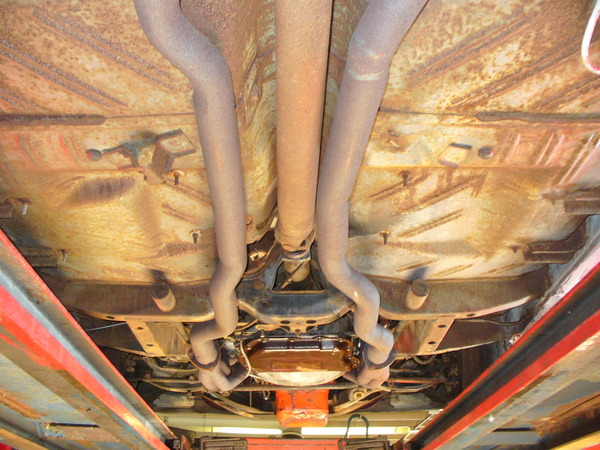

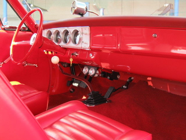

As usual Dave some good stuff there :thumbright: in the picture you can see the mopar trans mount thingy ,,,i guess this is no good for the manual box,,, has anyone got a picture of one??? can you still get the long hurst shifter?? DB was yours a $speed from the factory ... lets see your mount////
