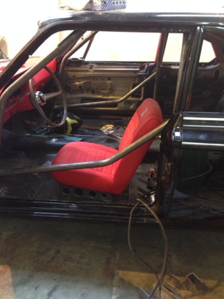

Jon as blue says your better getting one built, and the price will vary depending on how much cage you want, 4,6,8 point etc and what material, either CDS or chrome moly (also known as 4130) if it's street/strip a 6 point (main hoop, 2 bars to the boot and 2 door bars, these can be made to swing out for easier acces) cage in CDS would be more than adequate, (this is all you need to run 10.0-11.99 in completion)

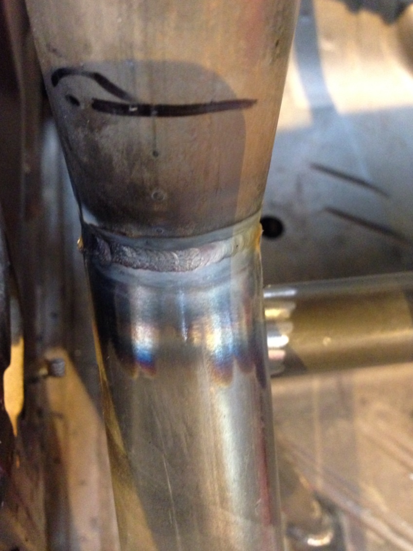

Moly is around half the weight of equivalent cds tube, but is much harder to bend/cut/notch, worth it in the end tho, next time I'm at the workshop I'll weigh 1 meter of 1 5/8 moly and cds to get a comparison if you want

Jon Webster built the cage in Pauls Hurst a Like 68 Dart Beauty
full cage £850 built and fitted 5 years ago though
