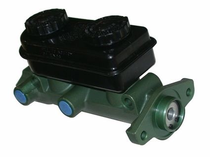

My intended set up
1. Bulk head adapter from 4 stud to 2 stud
2. Performance master cylinder not sure if it 1.125 or 1.032 bore (same as in picture)
3. Standard Chrysler proportion / split valve
4. Line to rear bias valve in line
Rear brakes drums
Front brakes viper 4 pots
Never liked servo and possible low vac as blower motor
Thoughts on this set up please gents
Many thanks
Will

Yep, that's right but the ball-breaker is knowing which bore M/C to buy.
Either loads or travel or very heavy pedal......

Have a stock m/c from a 90's voyager with stock disc / drum setup in my own Duster and works flawless. Don't know the bore out of my head but believe it's relative small for some pedal travel / feeling.
Looks like the same m/c in the pic though :thumbright:

Front port is front brakes
Rear port rear brakes

Biggest chamber is always for the Disc / Front brakes :thumbright:
So if I had one of those M/C's that would bolt straight to the booster I have
And connect to existing pipes etc ?

If your switching from servo to non servo, don't forget to consider your brake pedal ratio.
Non servo brake pedals have a higher ratio, from memory around 8:1 Ratio
Posts: 22137
Mossy, that M/C almost looks like it was a Manual one that someone has "adapted" anyway.
I have never seen a M/C with 6 holes in it (mind you it is not the clearest picture in the world.... ;) )

Pete. The M/C is correct for the car and has been drilled to fit the unknown booster. The booster works fine but has a two bolt design rather than the four. Thought perhaps the M/C Will posted up would bolt straight on and save me a few quid ?
