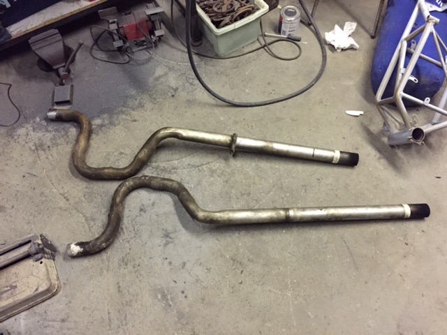

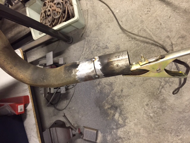

Thanks Steve I'll try that once I get her back on the wheels. Still feeling not great but went out and got the old exhaust off today got some assembly paste and hope to put them back on later.
There is a small hole approx 1/4 inch diameter on top of each exhaust pipe near the rear. Should that be there or should I weld it up before they go back on?
Also the left exhaust pipe is slightly dented where it goes over the axle and there is an addition bend that the right pipe doesn't have under the car. Is this likely to cause me any issues. No photos yet.
Most dual exhaust are not symmetrical around the centreline of the car, so I wouldn't worry too much. As long as it's not vibrating on the underside or anything else it should be fine. I'd not worry about dents either. Should have no effect unless the pipe is pancaked.Powermyster wrote:Thanks Steve I'll try that once I get her back on the wheels. Still feeling not great but went out and got the old exhaust off today got some assembly paste and hope to put them back on later.
Have no idea why there are any holes in the exhaust tubes. Should only happen due to years of use & rust. Some guys in the old days used to drill the back boxes to make it sound meatier. This is not really required on any Mopar. Flowmaster will make it sound proper...........I'd also add that holes in the exhaust tubing is usually an MOT fail if visible?

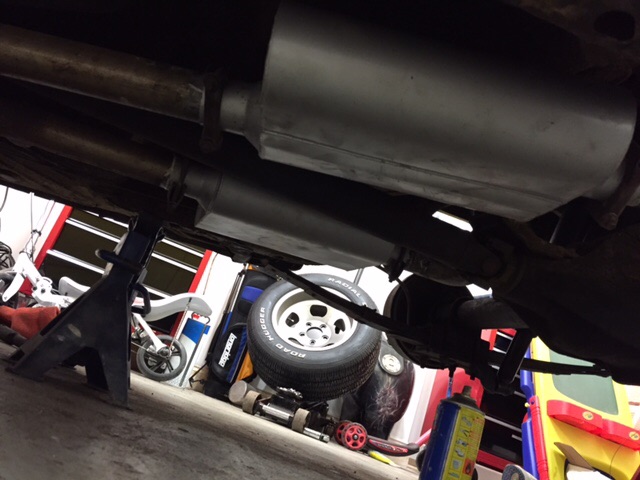

I ended up having to extent the pipes slightly and do a little welding. The holes are definitely drilled. They were too far back to be off tailpipe trims. I left the holes there for now. The were actually under the pipe so I can weld them up another time if needs be.
Huge difference in the sound now, and got the tailpipes tucked back online with the rear of the car. Also think I fixed the loose mount that was causing the right exhaust to rattle.
