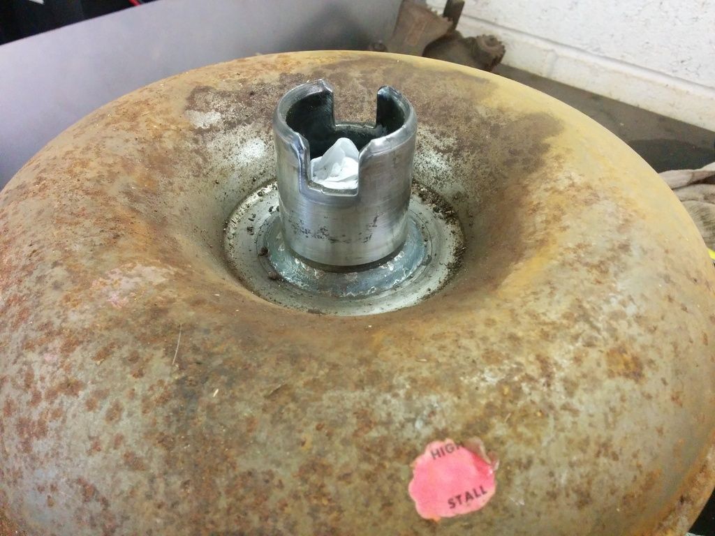

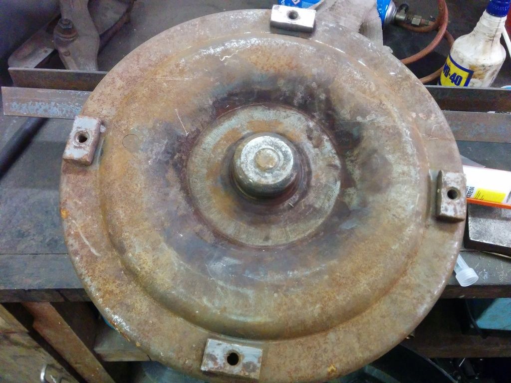

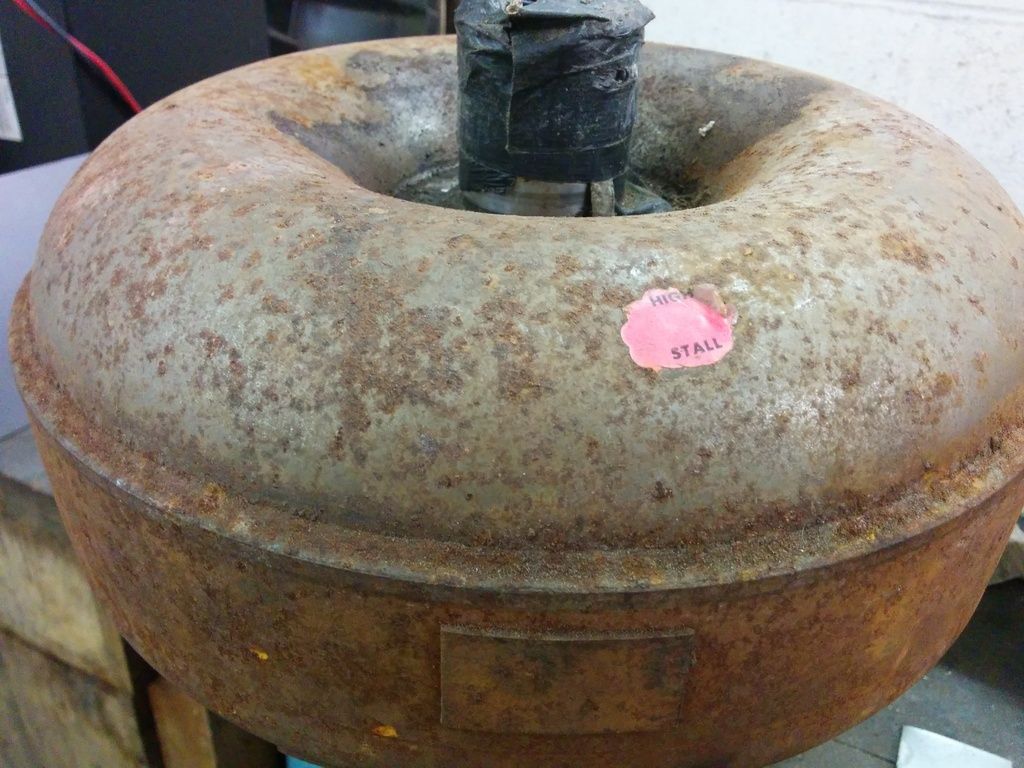

Here's a couple of pictures.
I'm not even sure it is for a 727, only thought it was , as it came with a 727 Range Rover auto box.
I thought it was new , but its used, and it's got a bit rusty in the shed for the last 20 years, but it was sealed to the elements.
what do you think ? :thumbright:

Mopar converters have the starter ring on them.
Posts: 22137
Yep, I don't think that's Mopar....My Ch@vy convertor has 3 bolt hole tabs so maybe a Fraud one :scratch:

Could be amc

DaveBishop wrote:Could be amc
It came with some Jeep and Range Rover stuff :?
