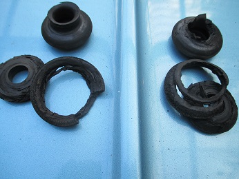

Just finished it,between other jobs.
Bushes totally shot and the wrong type. New original type now fitted.
