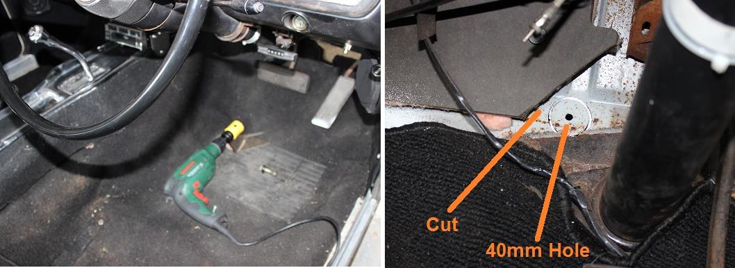

1) Remove driver's seat.
2) Remove brake master cylinder.
3) Remove rocker cover.
4) The core plug can now be felt just level with exhaust manifold on back end of cylinder head. To actually see it use a dental mirror (Maplins sell them) with a pentorch.
5) Use creases and holes in bulkhead to work out where you could drill a hole so it would exactly line up with the core plug. Get inside car and mark out the same spot, using same folds in the bulkhead metal as your reference points. Cut corner off the cardboard/foam insulation panel with a Stanley knife.
6) Buy a decent 40mm hole cutter for an electric drill, approx £30 complete with arbor that fits into the drill. Check it cuts metal.
7) Measure twice then from inside footwell of car, drill out (once) a 40mm diameter hole. Be careful, there are brake lines just above your hole on engine side of bulkhead!

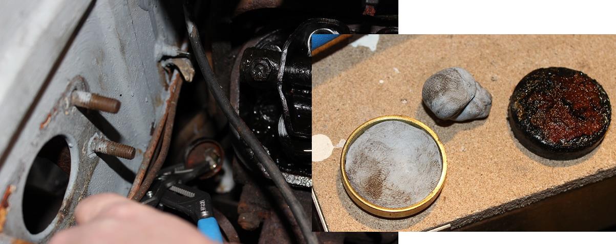

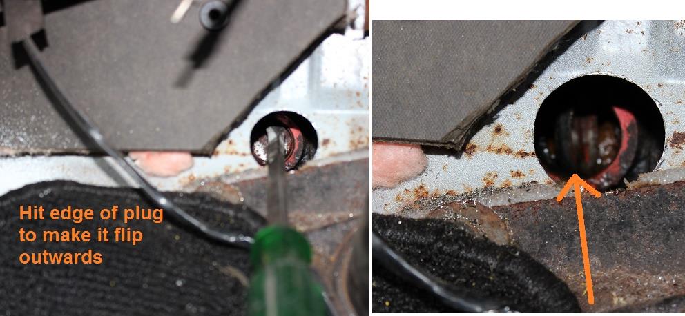

9) Put it through hole so tip is resting on the left or right edge of the coreplug (lots of youtube vids on how to remove a coreplug). Hit it with small lump hammer until coreplug flips round so now edge-on to you. Water will leak out, probably good thing if it carries any crud out with it.
10) Get out of the footwell, stretch those joints, then from engine side use a pair of adjustable grips or similar (that work around a corner) to reach in, grab the core plug and wiggle it round until it comes out.

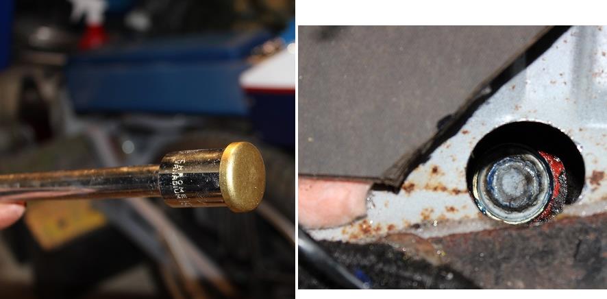

15) Fit a socket to end of a long socket extender bar and use flat layer of blu-tack inside the core plug to stick it to end of the socket.
16) Crawl back into the footwell and, with pentorch taped to the socket extender bar, go for it and tap the new core plug into place bit by bit. Keep going round to engine bay and checking how evenly it is going in, and which angle you need to tap to get it in nice and level. Take your time, do it bit by bit, get it right first time! Rather than tapping I ended up having to hit mine pretty hard.

- Stick plug to socket on socket extender, drive it into place through hole in bulkhead while lying in the footwell.
- 4.JPG (54.32 KiB) Viewed 970 times
- Pull out coreplug, prepare new one, blu tack to hold it to end of driver socket
- 3.JPG (107.02 KiB) Viewed 970 times
- Hit edge of core plug and flip it round
- 2.JPG (85.22 KiB) Viewed 970 times
- Remove seat, prepare drill with 40mm cutter, cut the hole.
- 1.JPG (83.84 KiB) Viewed 970 times
