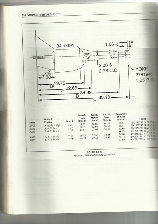

Theres a correct method of measuring yoke engagement, it's in the DC chassis book. I'll have a look later on unless someone else has it to hand.
Blue wrote:Theres a correct method of measuring yoke engagement, it's in the DC chassis book. I'll have a look later on unless someone else has it to hand.
:read2:
Posts: 14459
Ok here you go, hopefully you can read them, 4 speed, 727 and 904.

So from centre of UJ to 727 auto the distance on the yoke should be 3 and 3/4 inch if I read right. As long as I don't have to mess around with shims and crush sleeves it sounds good.

In which case my existing prop is fitted pretty much correct with 1and 3/4 inch exposed :o
