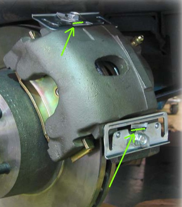

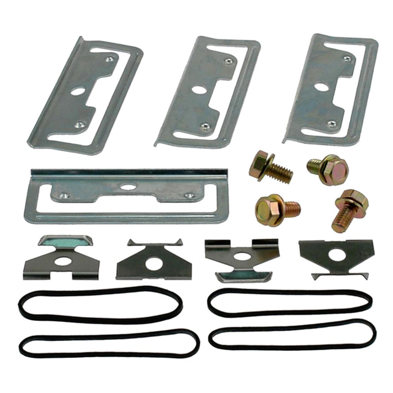

slider caliper ? , if so , your not going to believe the factory fix for this ! rubber bands , it hooks around the inner disc pad locating ears then round the anti rattle bracket clip thingy , see below , not 100 % how this goes , it was a long time prolly late 1988 & my brain has long since forgotten , I pulled a complete slider disc brake set up off a late model dodge , police car , took it all apart to check stuff , that's when I saw the rubber bands :? obviously refitted how I found them . still got the set up in the shed , but the rubber bands long since rotted away :shock: , today we got digital cameras , now I take pictures before dismantling stuff haha
see pictures below ,
never seen a picture of exactly how they go ever , who knows , they might not even been installed correctaly , on the set up I bought
picture 4 shows it as a o ring ?
await to be corrected on any of this :thumbright: :oops: :lol:

Steveo,yes that is the setup I've got.Don't recall seeing any elastic bands in the kit,and no mention of them in the installation instructions,and as Dave81 mentions not sure if hot brakes and elastic bands are a good mix.
