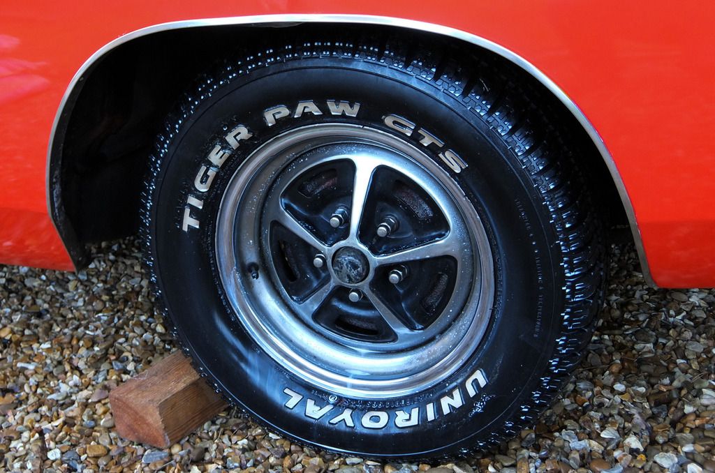

Evening all. I'm looking for a set of new tyres for my existing Magnum 500 wheels. I believe they're 14x7s all round.
(Excuse the mid-cleaning shot, haha)
I've searched around and found the following suggested:
215/70 R14
225/70 R14
225/75 R14
Which would you best recommend? I only ask because I'd hate to order a set and find they're not quite right. At the moment it's got 235/60 R14s on it and they're too wide, so it moves around on the sidewalls a lot.
Similarly, if you've got any suppliers or brands you'd recommend, suggestions are welcome!
Thanks!

Pete wrote:I am sure 70 and 75 Aspect ratio tyres will move around a lot more on the sidewalls than the current 60's.
That's a very good point. :D Are the current ones just not a bit too wide, though? They look a little ballooned, out from the rim, which I'm sure doesn't work too well. Reverse tyre tuck, haha.

Your Tiger Paws look a bit under-inflated.
What pressure are you running - this can make a big difference too.
