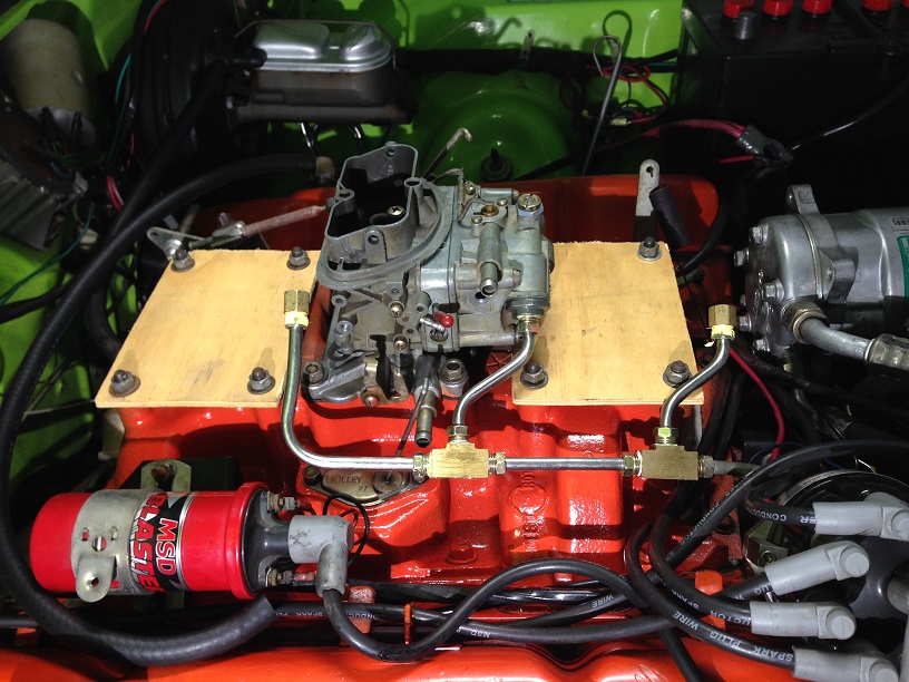

This thread on another site showed the guy removing the outboards and blanking them off while setting up the center.

A genuine 6 pack idles on the outboards as well as the centre carb to ensure the fuel does not go stale with lack of use.
Jenson SP's do not work this way.
