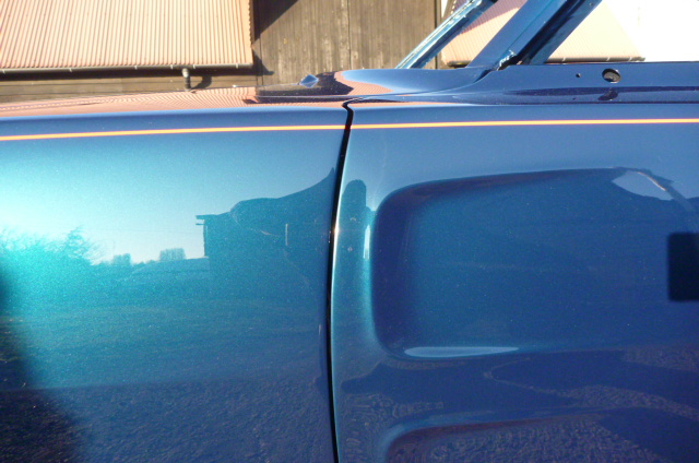

Hey John. Have you got it back from the paint shop yet.

hi dell yes now got it home & wrapped up cosy in gaarage waiting for me to finish putting back together [-o<
yes dana would have been way to go but engine upgrade wasnt planned so the 8 3/4 is all seamed weided, smoothed and shiny paintwork with nice new diff 3.23 suregrip
so gotta use it.
