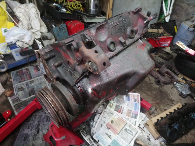

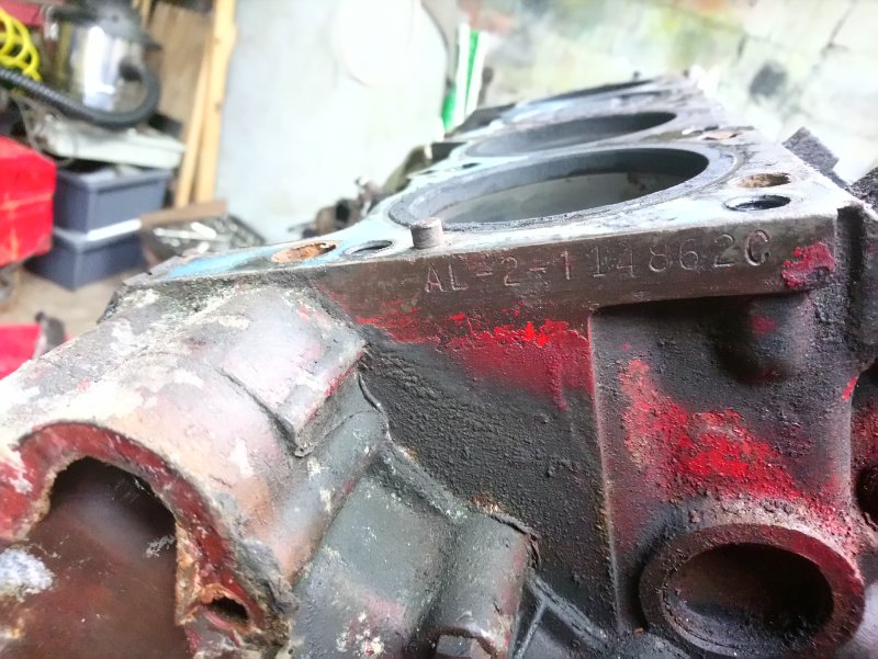

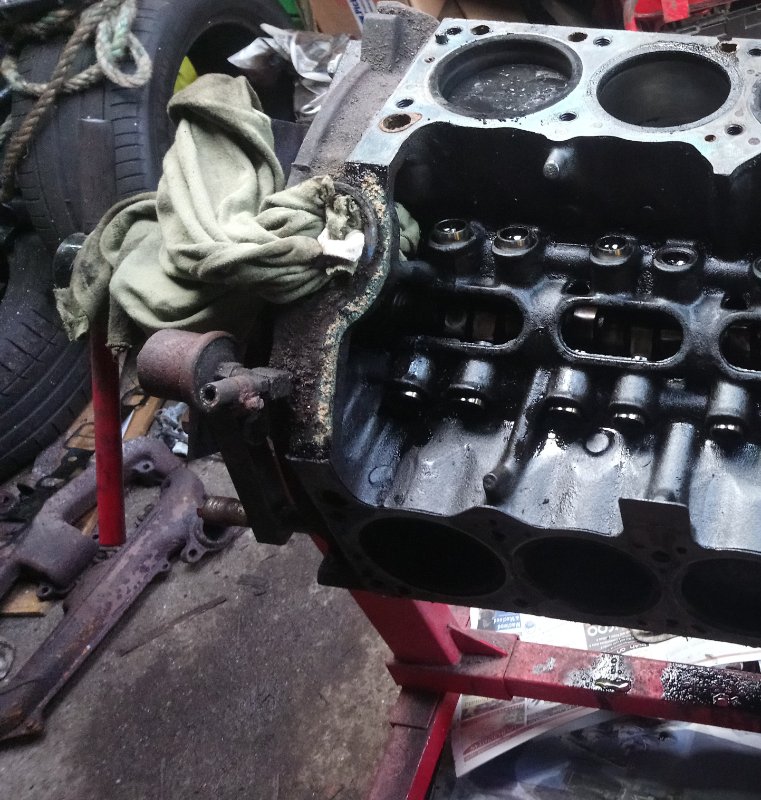

As in my workshop thread we stripped the engine down today.
This has raised some questions...undoubtedly its not the original motor but what is it?
I'm hoping someone here can shed some light on what I have.

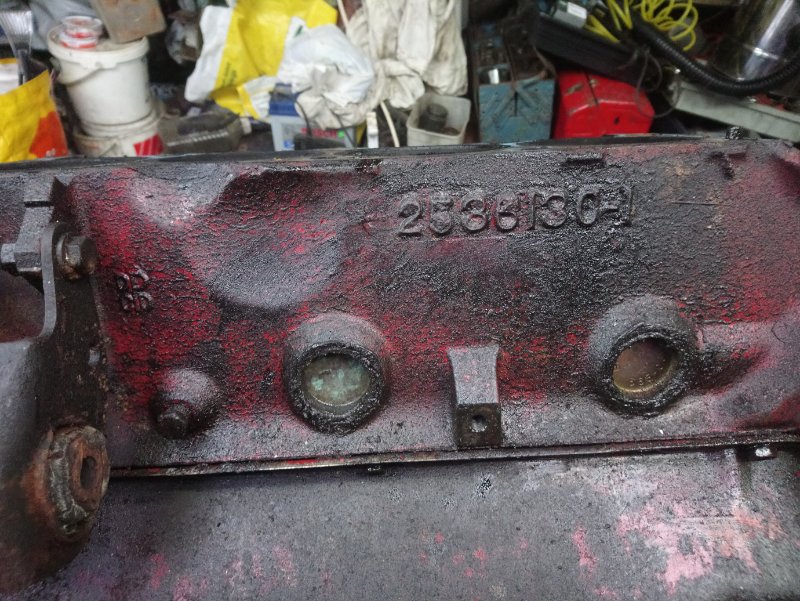

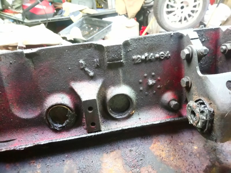

Firstly the block is painted red, also I think it may be a 273 going by the casting numbers BUT why is there no provision for an oil filter?

Hi,
Link to useful article https://www.forabodiesonly.com/mopar/am ... -block.35/
Block is 65 273 cast day shift 12-14-64
Perhaps someone can help with the stamped numbers.
Chris
Chris

filter usually goes on a right angled adapter passenger side under the rear most exhaust runner.
i.e if looking at/facing the flywheel or converter its on the right hand side at the lower back of the block...or it usually is.
or if you want to be australian it goes right where the steering box wants to be so....
a flat adapter with 2 pipes goes there and you have the filter upside down sitting at the front of the inlet manifold on an adaptor and bracket. for maximum mess and oil fumes once you change it.
i don't know a v8 well enough to understand what i'm looking at so i can't tell if you have a photo of the area or not.
if your block has no filter boss id imagine it can be drilled and tapped after the pump but before oil is distributed for a remote filter set up. just make sure you have the oil going through the filter the correct way (the adaptor usually has IN and OUT cast into it) and you block the gallery between outlet and inlet so the oil actually goes through the filter, all of which will need to be done on a bare block.
last one i did was a VW that involved a pipe on the outlet side of the pump cover.
the normal pump outlet being plugged and a plug in the end of the main oil gallery being drilled and tapped for a pipe barb.
oil from pump to filter
normal pump outlet blocked with grub screw and loctite
oil from filter back into block at the first corner after the pump
i'm guessing when i suggest it for a v8 but hey they ain't that different
Mocal/Think Automotive in isleworth can usually supply all of the parts to do this kinda thing.
- ScottyDave
- Posts: 1674
Re: What is my engine?
Cheers Dave, yeah there's no oil filter boss to attach a filter. Not looked at it too closely as I'm busy welding the shell. Once I get the engine back home I'll be able to spend the time on it.
I have never seen a small block without the large circular cavity for the oil filter adaptor before, surely must have the oil filter mounted somwhere else? A 3rd gen Charger with a 273 will be somewhat sluggish, I would be looking for something bigger rather than rebuilding that.

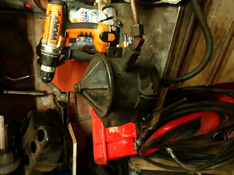

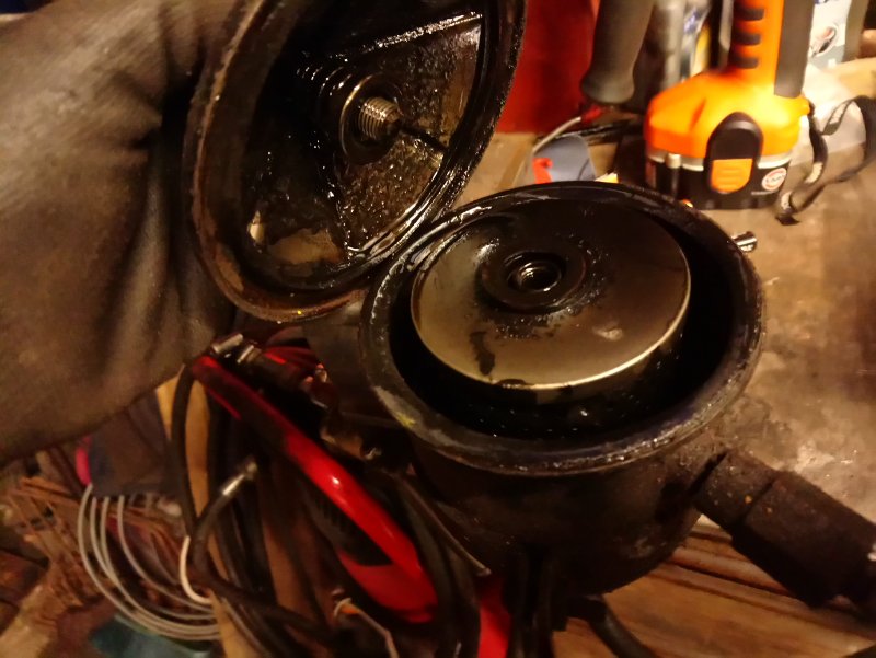

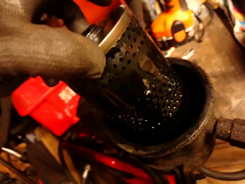

Okay I've found the oil filter
I was in the garage this evening sorting out a bench so I can get the block of the floor and in the process of moving things around I picked up what I thought was the vapour canister... Oil dribbled out of it
So I decided to open it up and have a look
Yep one oil filter, which I unknowingly brought home with me a couple of years back Duh in my defence we did pull the motor 3yrs ago and as it was in the vapour canister location, well its a slim excuse

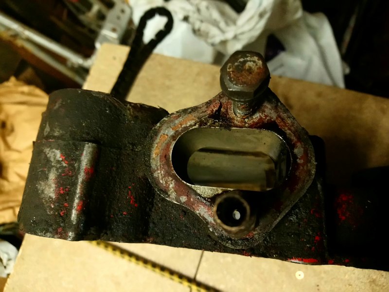

That got me thinking as to how it must have been connected, firstly the oil pressure sensor is on a Tee
and secondly one of the bolts holding the fuel pump is hollow

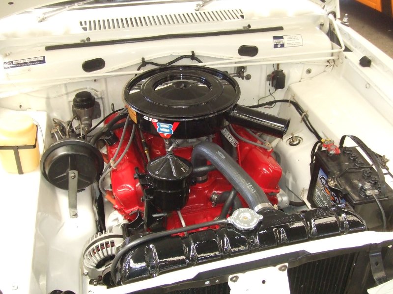

This got me thinking about something Dave999 mentioned about Australian motors so a quick search and this 1965/66 Valiant AP6 popped up
in this picture you can see the same oil filter housing bolted to the engine , the supply line running to it along the inlet manifold and the return line coming out of the bottom and heading down to the fuel pump.
Re: What is my engine? Possibly sussed it
Good detective work, that certainly seems to be what you have there. I wonder if all the early 273s were like that or if it is for an industrial application that just happened to suit the Aussies needs? Every days a school day in the world of Mopar...
Oh they are good and quite effective. only thing lacking might be anti drain back
and with that kind you are not taking off a canister type filter with the dribbly end down
- ScottyDave
- Posts: 1674
That's good to know DaveDave999 wrote: Tue Nov 13, 18 1:09 pm Oh they are good and quite effective. only thing lacking might be anti drain back
Worth keeping then? I have thought of replacing it with a remote screw on canister.
I'm just glad that I have some idea of what the engine is and how a filter fits in.
