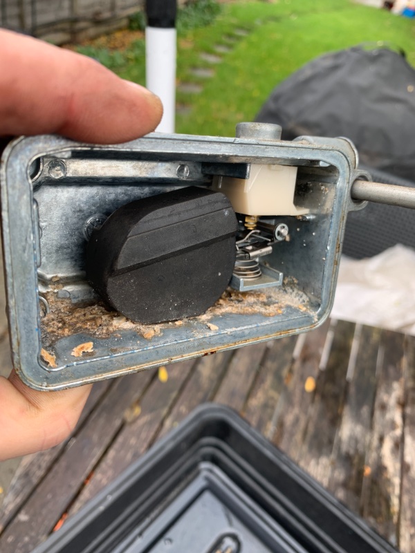

E10 petrol dissolved the glue holding the paper fuel filter inside the clear plastic canister. You should’ve seen the crap in the float bowls!!! Rotor arm spins just fine when the engine is cranked on the starter motor. One strange thing is the firing order. I’ve done the finger over the no 1 spark plug hole and get a fat gush of air when the rotor arm is at the 10 o’clock position. But before I started all of this the no. 1 plug lead was at the 4 o’clock position????

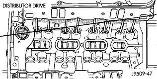

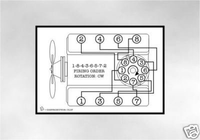

ah ok
you need to set it up thus dizzy drive section pointing at that far stud on no.1
and the leads in the correct position on the cap
in this position you are looking to see both valves closed on no.1
and the rotor arem pointing to no.1 tower on dizzy cap
4 stroke so TDC mark on balancer aligns with the marker on timing cover tab twice per cylce but only one of them is the firing point with both valves closed. the other is the top of the exhaust stroke pointless slinging in a spark then..... :)
318 firing-order-jpg.jpg (15.01 KiB) Viewed 3053 times
