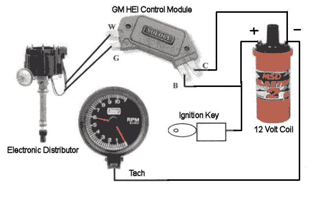

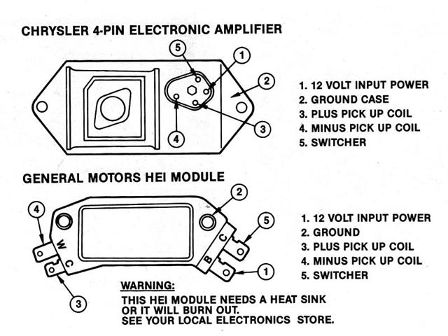

Posts: 9561
cheap as chips
works
mopar electronic dizzy
Blaster 2
4 pin HEI module
this search for modules on ebay
(AC DELCO,Wells,petronix,car quest,Napa, niehoff,Borg Warner,GM,Mallory,jegs,moroso) (DM 1906,D1906,ACC35361,aCC35367,D2000,21040,ECH TP45, Dr400 ,CBe4,cbe22,10482820,607,555-40600,97857) (module,hei,)
use a coil designed for 12 volts with 0.5 to 0.8 ohm primary
i.e
Blaster 2
or
and these are only £20
http://www.ebay.co.uk/itm/lucas-DLB198- ... 462ed78576
or indeed
an HEI coil like the one used with the module originally
search
HEI coil (DR-35, E41, DR-182, IC22, 342D, GC400,D525)
Obviously if going racing then there are probably better alternatives
but for a reliable street set up....for notta lotta cash

Posts: 7309
Location: Cornwall
Post by MilesnMiles »
Dave, I posted a similar set up like this as a query. I think Steve has one on his Polara.
Thanks for posting up the cheaper coil option :thumbright:

Posts: 9561
if you need to buy a new dizzy the n its not the right option
economies of scale are lost....buy a package from any one of the BIG ignition people.
but if you have a dizzy you can be back on the road for £30-£40
Dave :thumbright:
