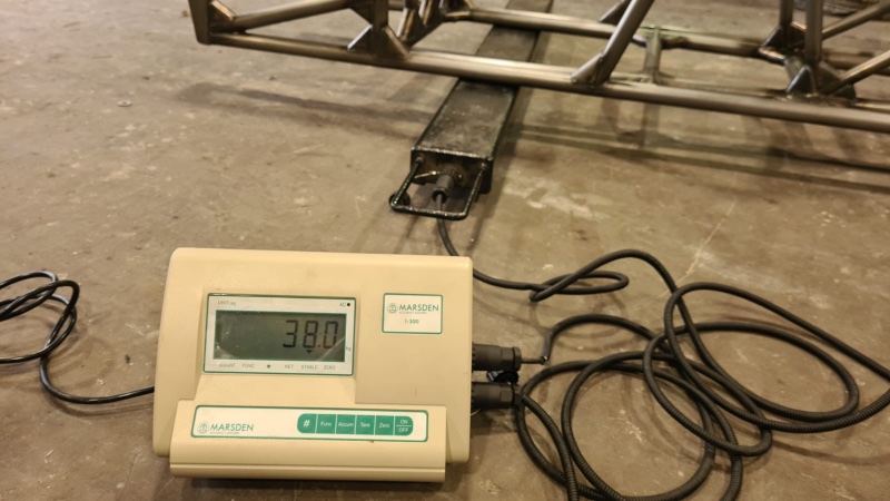

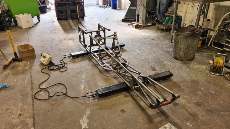

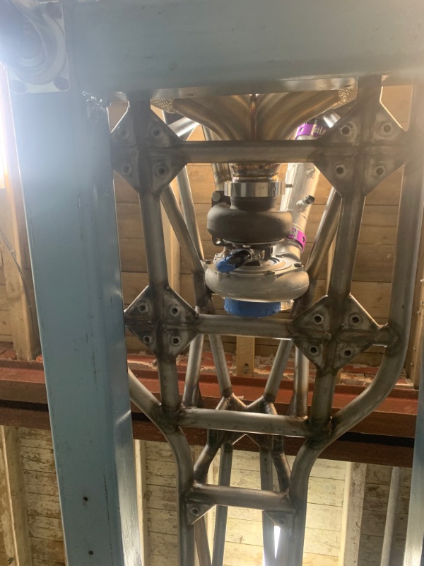

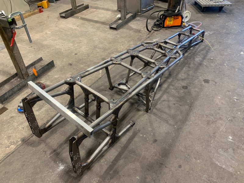

RobTwin wrote: Fri Sep 25, 20 1:11 am I hope the frame is still the same weight you had planned for... :-k :shock:
Frame all done and it’s 38kg !! \:D/ \:D/
Compare to a B body I’m quite happy and I think this is good ??

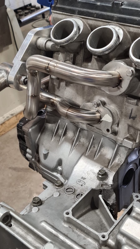

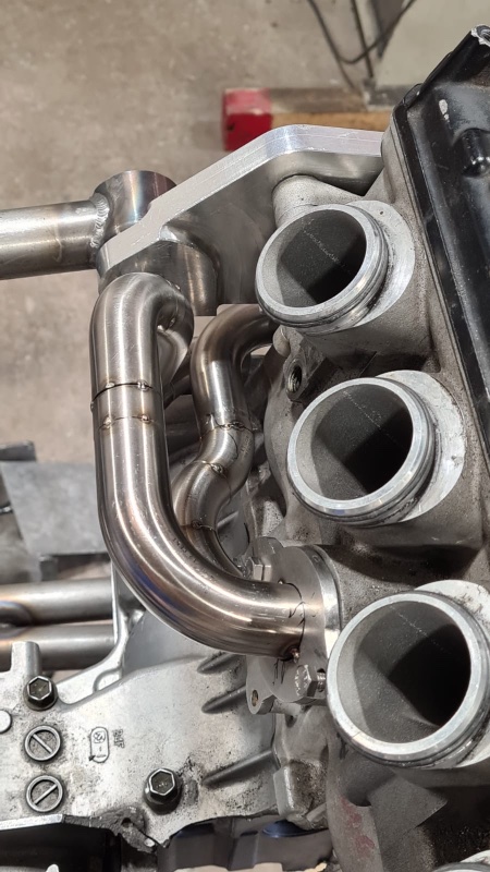

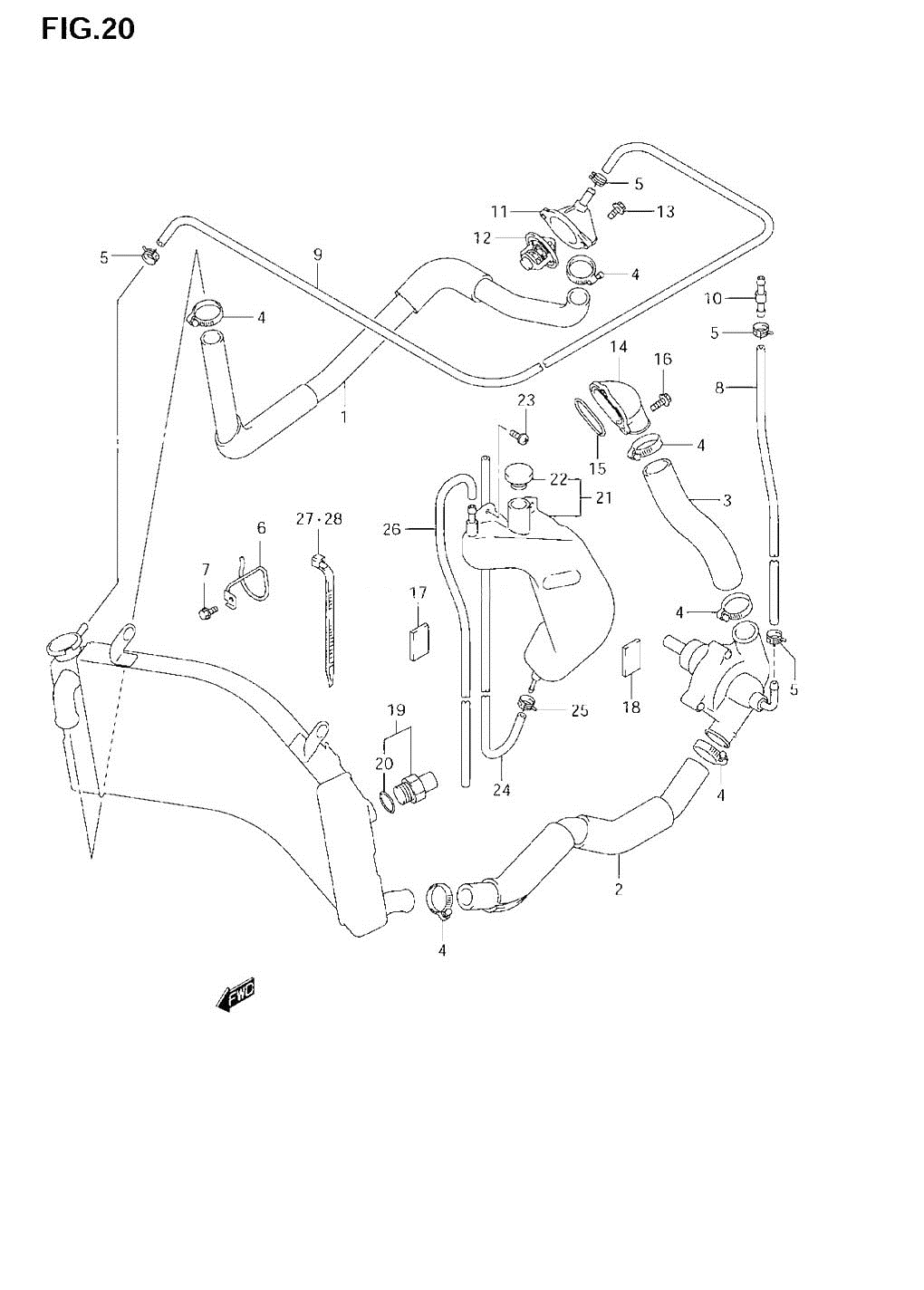

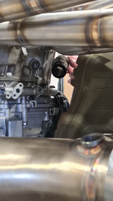

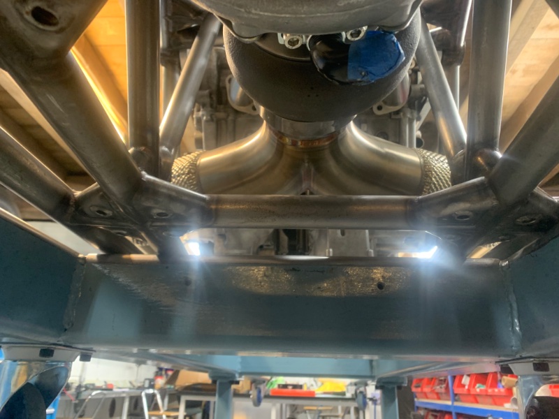

Next up radiator engine hoses

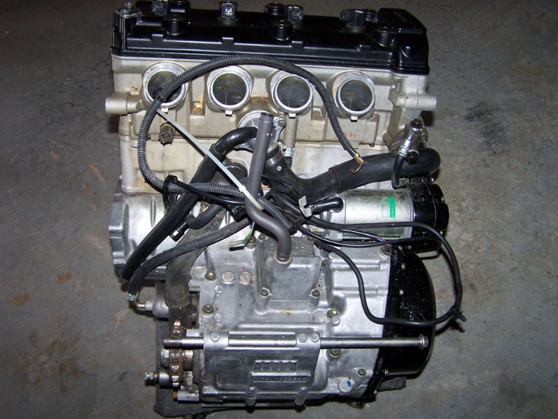

On a standard hayabusa these are the standard factory mess
so started making some stainless ones and will be using AN16 Braided lines braided lines for all coolant.
Just need to decide where to put the rad
:-k :-k :-k :-k :-k :santa: :-k :-k :-k :-k

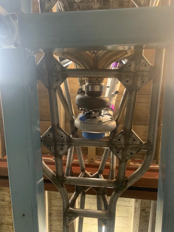

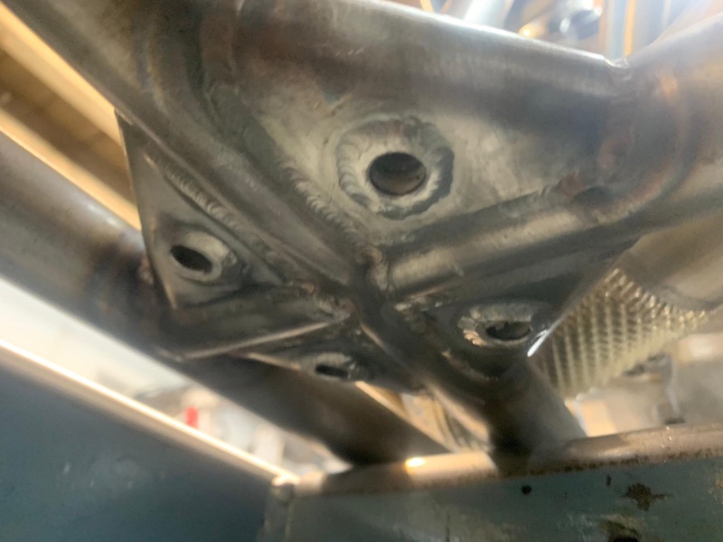

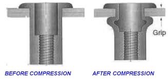

Under-tray or some sort will need to bolt to the bottom of the chassis.
I added lots of rivet nuts to all the gussets underneath and then welded every one in so it’s 100%
Never used them before and think there quite good :thumbright:
Re: Fifty shades of Jade
We use a lot of rivnuts at work. Seem to work well. Had no problems so far :thumbright:

Mossy68 wrote: Thu Oct 08, 20 10:21 pm We use a lot of rivnuts at work. Seem to work well. Had no problems so far :thumbright:
Same here :thumbright:

SCTA rulebook says not to fill the corners of gussets. Not sure why, but that’s what it says.
Posts: 1350
Bratfink wrote: Fri Oct 09, 20 1:18 am SCTA rulebook says not to fill the corners of gussets. Not sure why, but that’s what it says.
Dirt Trap / Drainage?
Added stress in the corners?
And there was me thinking a filled gusset was a good thing #-o :roll:
RobTwin wrote: Fri Oct 09, 20 1:31 pm And there was me thinking a filled gusset was a good thing #-o :roll:
There not gussets there Partial tubes very different :thumbright:
A great design adding maximum stiffness for minimum weight to the chassis. :thumbright:

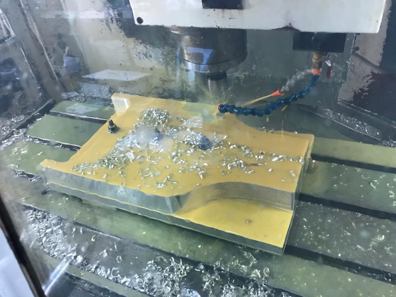

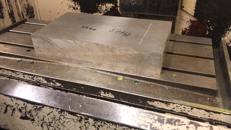

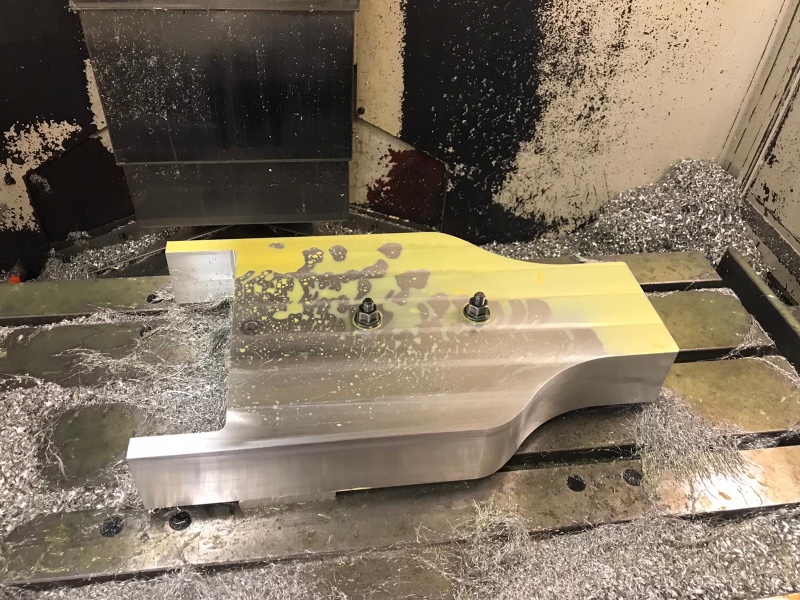

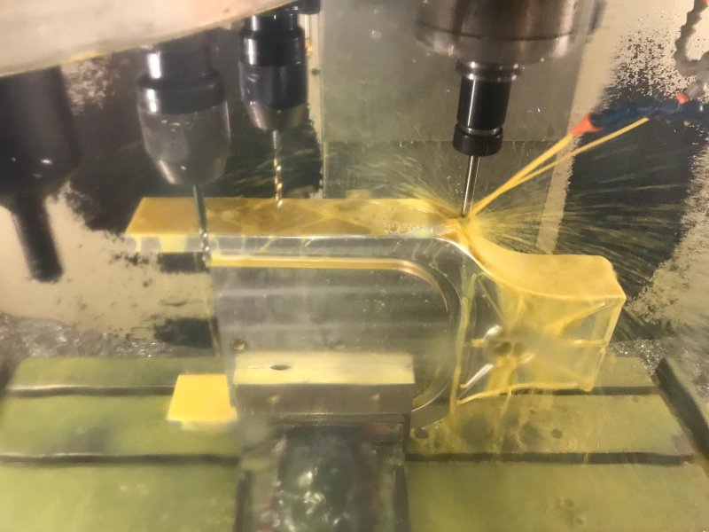

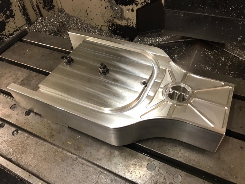

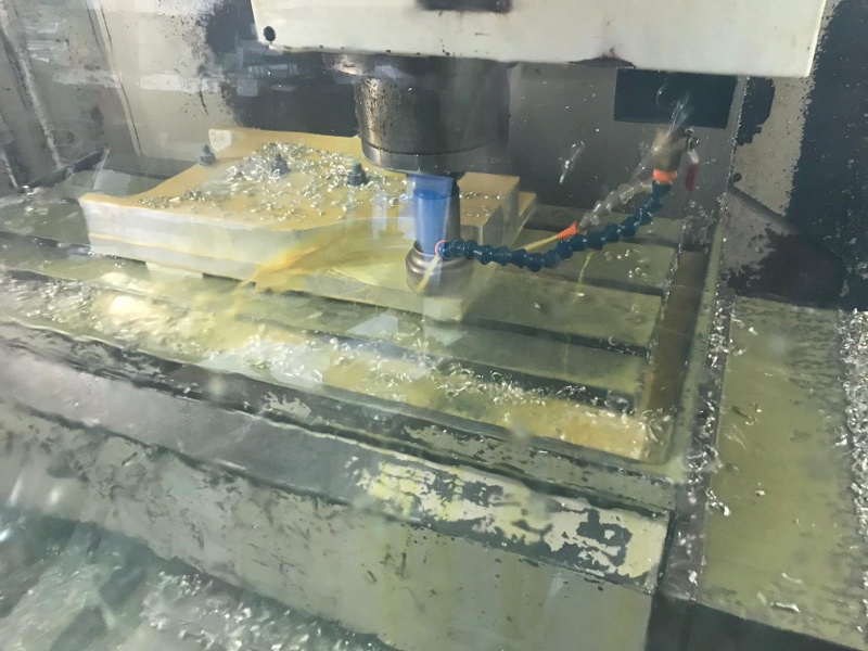

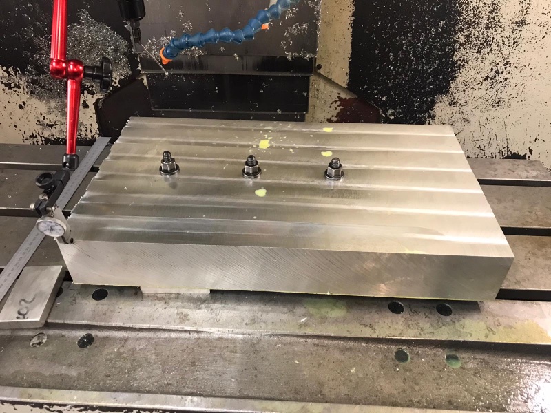

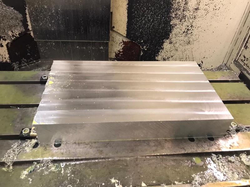

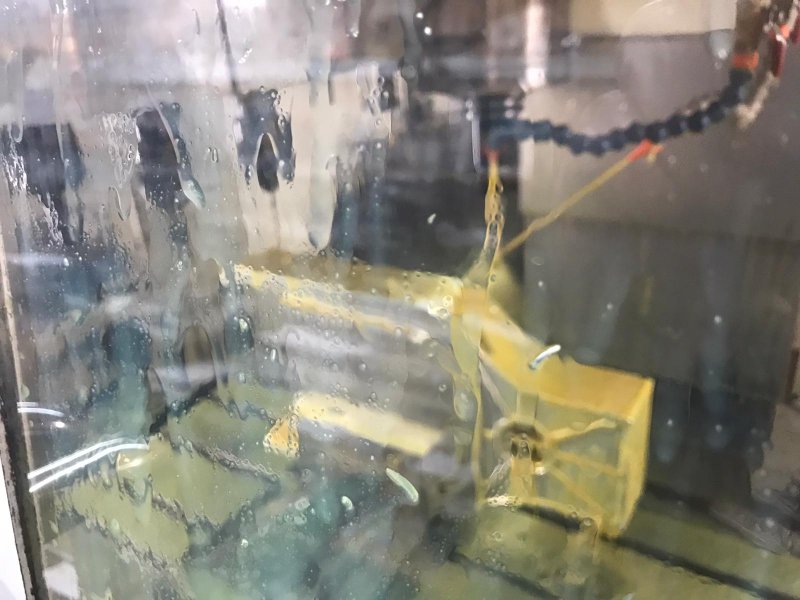

40kg block of aluminium.
1000mm x 70mm x 500mm :shock:
Under 5kg when finished !!!
The milling machine has started !!!!
:shock:
